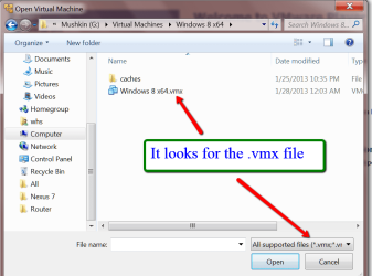

Since you have displaced the original installation, you have to point VMware Player to the new location. Open VMware Player and you will see this window.
After you clicked on "Open a Virtual Machine", an Explorer window opens where you have to navigate to the virtual machine folder on your device. There you drill down until you find the file with the .vmx extension. Highlight and open that file.
Now the virtual system on your external device is recognized. You will be back on the VMware Player window where you highlight the system you want to play on the top left and then click on "Play Virtual Machine".
You will be asked whether you have copied or moved the folder - click on 'Copied'. The system will take a little while to start this first time. Both VMware Player and the OS seem to make some adjustments.
