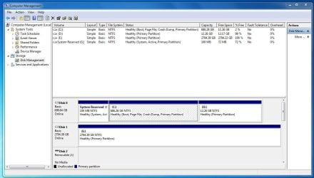

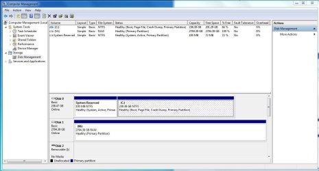

Kaktussoft, here are screenshots, first one is with the SSD installed, The second is with the 750 HD installed,
