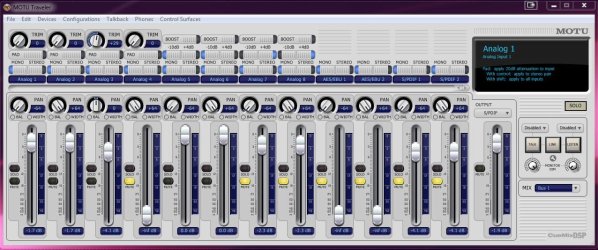

I have my MOTU Traveler firewire as my default device. When I play games, that causes a fps decrease. So before I start a game, I make onboard the default device. I have the output of onboard audio patched into my MOTU 5 + 6 analogue inputs. So I don't have to do anything else besides possibly making sure they're not muted in MOTU's mixing panel. Just use onboard for games and otherwise, my MOTU is default.
For anyone curious, inputs 1 + 2 are for my guitar inputs, stereo from Digitech RP-12. 3 is a mono channel which a Shure SM-57 mic is connected to.
