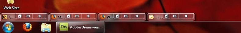

Hello All
I upgraded from Vista Ultimate 32 to 7 Ultimate 32.
The only quirk I cannot solve is that I see no apps on my task bar. ANd when I minimize a window it does not go to the task bar as it should. It look like a small minimized window. See attached snip.
Any ideas?
Tim

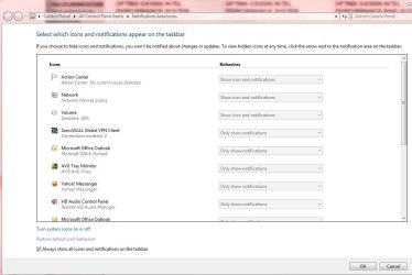

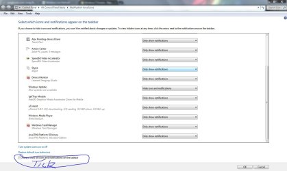

If that doesn't work, right click the taskbar and click properties. [See Screenshot Called Properties]
Then under Notification Area click Customize. [See Screenshot called Customize]
Then tick the box at the bottom and click apply. [See Screenshot called Notification Area.]
Try that and report back!

Done as asked and no change (other than all icons in notification area). As you can see I have a few Firefox windows, Quickbooks and Dreamweaver. DW is the only one that is acting correctly.
Thanks for the upload tip. I went to "Manage Attachments" below and the window would not open.

Hi! Could you show me a snapshot of the Window you get when you click Customize??

Nope. IE, Quickbooks, Yahoo, iTunes etc.
I have been thru every setting that I can find and I am thinking it is a Bug
