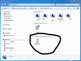

I have a home network connecting 4 computers, 2 print servers, and a media bridge to a Linksys wireless router. Pretty much the same setup from XP to Vista to Win7.
After installing Windows 7 x64, I am seeing a device under the category "Infrastructure (1)" on my Windows Network screen. It identifies itself as "WNR843Bv" - a Netgear router - which is definitely NOT a device on my network! Maybe it belongs to a neighbor, I can't verify this. Other than this - the network is functioning as expected.
I use WPA2 encryption and MAC Address filtering on my Linksys router, so I am (reasonably) confident that this device is not connected to my network. However, I am not comfortable with this.
Can anyone help me understand :
(1) What is an "Infrastructure (1) device?
(2) Why is it showing up on my Network screen in Windows 7?
(3) How can I get rid of it?
Thanks.

BUMP!
I attached a screenshot to illustrate the problem. The mysterious network device is circled. Thanks!

That's your router. I'm willing to bet 20:1 that you installed a 3rd party Linux based firmware on it, right? Something like DD-WRT? I dunno really though. Just a guess.

You're partially right - I do have 3rd party firmware on MY Linksys router - however, the device showing as "Infrastructure (1)" is not my router. How do I know this?
(1) When I do Right Click > Properties on the device in My Network, it reveals its MAC Address, and that it's a Netgear RangeMax Wireless-N Router - which I do not own.
(2) I did a WiFi scan with inSSIDer (cool app.) and it clearly identifies that one of my neighbors is using this Netgear Router on his network. inSSIDER identifies it by the MAC Address, so I am pretty sure this is the router.
(3) My wireless network is locked down with WPA and MAC Filtering. I use Channel 1. The neighbor's wireless router uses WEP and is on Channel 11.
So, why is this device displaying as "Infrastructure (1)" on my network?

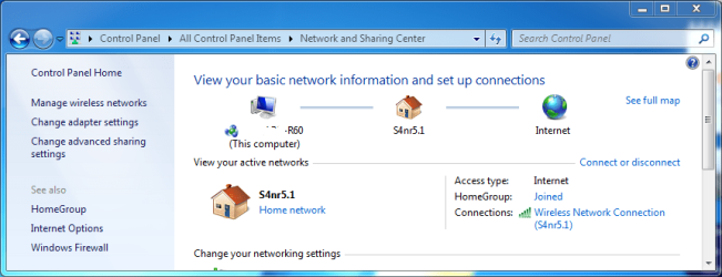

Here is my network configuration:

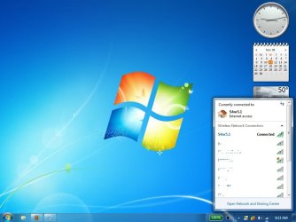

Here is a screenshot. It shows that I am only connected to one network - S4nr5.1 - which is mine. The 2nd network on the list (it starts with the letter "p") is the one with the Netgear Router that comes up as Infrastructure (1) on My Network. According to internet connections, I am not connected to it.
I am stumped. Thanks.

What concerns me more is that some of your machines aren't even showing up as officially connected to the network map. That usually indicates a problem.
I would completely reassemble the network starting from square one. All of your networked machines should be part of the network string on that map. Unless you have them outside your network for some reason?
As for figuring out if that netgear router is using your internet connection use wireshark to map all the network machines using your network.

Wireless transmission between your router and the transceiver on your machine takes place over one of several frequency channels. Have you tried using a different channel?

Changing channels would probably get rid of the rogue netgear router connection but that doesn't explain this strange network map which seems to have all the wired computers not included or being mapped. This isn't right.
