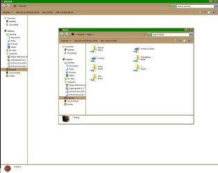

My issue is when I click on "Network Icon" on my desktop I should see all available network options for my computer running windows xp (the folders that have been set to share) however I don't see anything.

Can you take a snapshot of what you're looking at and upload it for us to see?
Attached
Computername shows what I see if I do the \\Computername
Network Icon is what I see when I click on the network icon from my desktop
