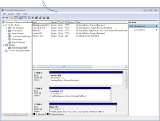

At this point, we can best advise you if you post a screenshot of your full Disk Management map.
Use the Snipping Tool in the Start Menu, attaching file using paper clip icon in reply box.

here is a screen shot of the drives

here is the screen shot

here is the screen shots

I don't see B: drive you refer to, where you reinstalled Win7?
Looks like it is Disk2 which is labelled E: on screenshot, right?
The first problem is all of the other drives marked Active, even the movie drive.
EasyBCD won't work here because it will rewrite the MBR to where it is currently located on DISK1. You could unplug other drives and run EasyBCD from your Win7 desktop but the unplugging would have to be done while on the Win7 desktop and that is not advisable. And it will not boot back in to run EasyBCD if you shutdown to unplug those other drives.
You are going to need to mark those other drives inactive using free Partition Wizard bootable CD download below
Boot PWizard then rightclick on each of the other drives to Modify>Set Inactive, click OK.
Click Apply after all are done.
Reboot, enter BIOS setup and make sure Win7 drive is set as first HD to boot after DVD.
then reboot into the Win7 DVD and run Startup Repair 3 times to rewrite the MBR to Win7 drive.
