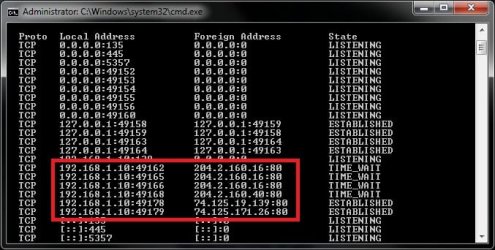

Port 1900 does not talk to port 2869. When opening a port there is always two. One for the server the other for the client, in most cases in the 49152 & 65535 range for the client. You can see this relationship by using "netstat -an".
Just by browsing the web there is several ports opened, you may talk to the server on port 80 but the server talks back on one of the dynamic/random ports.

Browsing the web does not open any UPnP ports period! all ports relating to web browsing be it non secure http or https and ssl use port 80 and 443 and these ports are almost always open by default depending on the router in question.
????? How ? ....
If you open up your browser and type a HTTP address in you will connect to the end point via port 80, if you type HTTPS you will connect via 443.
The only and quite common occurrence of port switching is if you go to a web page via http, and that page requires you to use https/ssl your browser will start to communicate on that port.

When opening a connection, port A is open for outbound communication to the server. At the same time port B is open for inbound communications from the server and only the server. This is called a solicited connection and these are what make it though. (Btw, the inbound port will never be the same as the outbound port, at least not for registered serveries like HTTP. Opening port 80 for outbound will not open port 80 for inbound.) (Don't even get me started on using hardware firewalls and NAT devices.)
If you do not believe me about this then just open "netstat -an" in a command prompt, all versions of Windows have it. Or review the attachment I've uploaded.
If you have UPnP devices on your network, they are going to need an outbound port while they are in the process of talking with the UPnP server. And by the looks of it, this device uses a dynamic/random port for inbound traffic from the UPnP server (aka., your computer).
