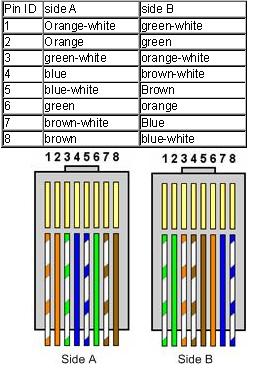

It was a 100' ethernet cable which I recrimped one end to "B" spec:

From everything I'd read it was as simple as modifying the cable, plugging it in and "sharing my internet."
