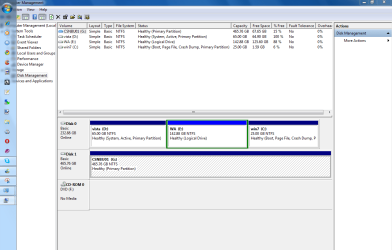

hi gregrocker
thanks; here's the info you requested.

Can you rt click the 7 partition in Disk Management and Mark as Active?
If so - do it.
Then type cmd in start search. When it pops up, rt click the black box and Run As Administrator.
At the prompt ( this bit > )Type :
bcdboot c:\windows /s c:
then press enter.
Close command prompt.
Restart the pc.

Can you move the data on the E: drive temporarily to the G: drive? This gives you a clean slate.
Did you burn Partition Wizard to CD? If not, please do so using bootable CD download: Free Download Partition Wizard
Now boot into PW and it should allow you to rightclick>Modify:Set active the Win7 partition.
Now you can rightclick>Delete both the Vista and E: partitions,
then rightclick>Resize/Move the Win7 partition, use slider to move left border all the way over against the left side of the HD. Resize the right border to Create any new partition(s) in the right hand space as desired. Apply all steps.
Now boot into the Win7 DVD Repair console, click through to Recovery tools list and run Startup Repair 3 separate times to rewrite the MBR to Win7.
You may wish to save a Win7 backup image externally or to your G: drive first because Resizing operations can fail.
You have two options available where you can still use the Windows Easy Transfer tool for 7. http://www.microsoft.com/windows/windows-7/features/windows-easy-transfer.aspx
The first is simply removing the first two partitions once you have backed up your important files to the second G drive you have available. From there you can use either drive partitioning program to move the 7 primary forward as suggested or second remove all 3 and start off fresh with a brand new single primary to see a fresh install of 7 go on that.
A third option although you already have a second drive available to add here is deletion of the first two with one having Vista on it and creating a new larger primary followed by reformatting the present 7 partition to use for backup or ? All you have to do besides that is decide how you want the drive scheme to look once you are done.
