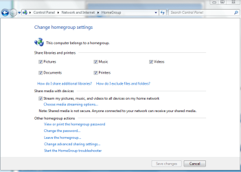

Try setting the Library to share folders then share with "Everyone" the link below shows you how. If none of the Library's are shared you will get that message. You need to check this on both machines.
Share libraries with your homegroup

Thanks but that didn't do anything. PC1 (MEDIAPC-PC) Doesn't show up under homegroup on PC2 (SEVEN) but can be see under network. Please see the image below.
BTW. I have shared folders and libraries on both computers but they don't see each other even though both are joined to the same homegroup..

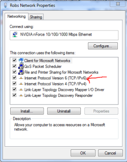

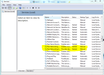

Make sure that IPv6 is enabled. In services make sure that all the three peer networking services are started.
Yes it is strange that it worked before and not now.
Somtimes it helps to create the Homegroup on a different machine and join from the other but it sounds like you tried that. You may need to uninstall Kapersky also.

IPv6 is enabled on both machines. Peer services are running on both.
Home network is set to trusted under KIS. Cant understand why it would decide to block it now? I'll try an uninstall.
