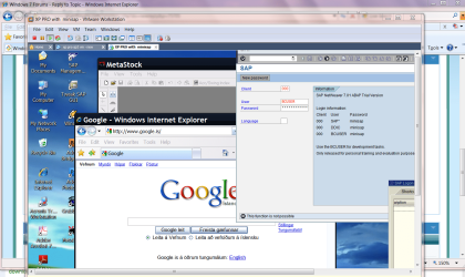

Hi there
1) can the HOST machine connect to the Internet -- this might be obvious but often the Simplest solutions tend to be the correct answer.
2) Is the Virtual adapter connected AND enabled.
3) Firewalls / router blocking the Virtual XP machine.
Incidentally when I did a W7 Upgrade I couldn't get VM networking to work at all until I'd re-installed vmware.
If you did a W7 Upgrade just re-install vmware (and vmware tools onve the vm is powerd on).
Normally NAT is no problem.
You could also try changing the Networking to "Bridged" although this can give problems if your HOST adapter is a Wireless adapter.

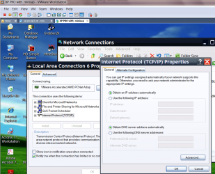

Hi there
if DHCP is disabled in your Dorm then proceed as follows.
It's a pain as you'll have to do it every time.
1) Get the HOST IP address and DNS from Control panel ===>Network adapter ==> properties or from Network / sharing center.
2) in the VM XP machine go to the Virtal adapter network settings
change get IP automatically with the IP address of your Host
You'll also need the DNS of the ISP server.
The default get via DHCP is set in the vmware adpter -- but you can't use this as DHCP is disabled in your case.
In my case (the default one) DHCP is enabled
Enc diagram
Cheers
jimbo
