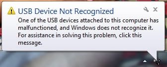

My Wi-Fi switch had a loose connection, and since my laptop was under warranty I got them to replace the entire bottom base for me. Immediately after the replacement, I started getting the error "USB Device Not recognized" [Attachment 1].

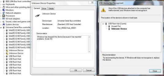

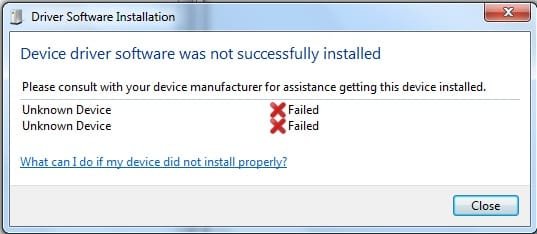

There were 2 unknown devices in the Device Manager [Attachment 2]. This was not present before. All my drivers (except card reader and sound) were automatically installed with Windows Update, so I tried to update the driver. However it was not getting installed [Attachment 3].
