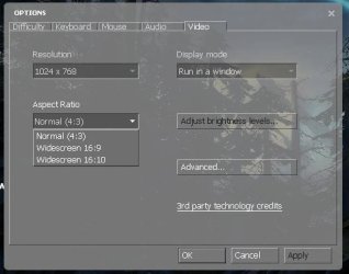

c - Are you using the correct resolution for the Monitor?Aspect Ratio 16:9 and 16:10 have different native resolution settings, and some games like Half-Life 2 – EP2 for example, require you to set the correct "Aspect Ratio" for a given resolution. For example, using HL2 EP2, if the aspect ratio is 4:3, then you can’t set a resolution of 1680 x1050. If your game has an Aspect Ratio setting, check it.
d - Full Screen Issues? Again, some games, like Half-Life2 EP2, have options to either run the game in full screen or Windowed mode. If you’re having issues with a game not running in full screen, you might want to check for this setting under video settings.

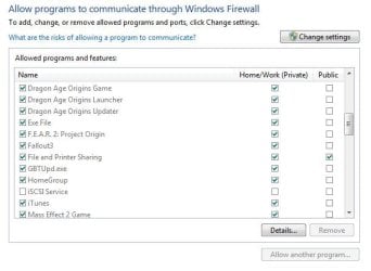

11b - Speaking of connection problems... check to see that your Anti-Virus or Windows firewall isn't blocking you. For Windows - Control Panel, Windows Firewall, click "Allow a program or feature through Windows Firewall" and that your game is allowed through (a checked box). Check your AV’s manual to access its firewall.

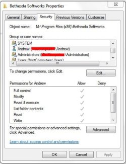

14Permissions – For various reasons Windows security features may limit permissions to folders or drives. If you’re having issues starting or saving games, check to make sure your user name is included in the "Security" tab and has full read/write permission for the game’s folder(s). Requires Admin rights! See Tutorial on Sharing and Permissions – If you don’t want/need to share the folder just do steps 1-7
