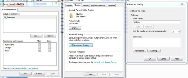

How about in this setting?
how about change this to full control on the folder you want to read/write????

It worked! Thanks, acurasd!
See, I was assuming that this would be enough:
And I suppose it would be if it actually did what it says. But I take it that it will only work for another Windows 7 machine? Are those "advanced sharing" permissions only necessary for XP?

Thank You Acurasd!! I could see the Win7 folder from Xp. I could open the folder from XP. I just couldn't move files from the XP drive to the Win7 one. :banghead: I had read and read about the security settings tab. Had set everyone to Full Access. I had NOT looked at the SHARING tab. :doh: Your picture was the inspiration I needed. THANKS!
