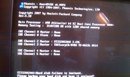

Working on my computer... Attached is a cell phone picture of the problem. Do i need a new HDD? If i press the F2 key it will boot up into Windows. This particular PC is running Windows Vista (Shivers) I'm thinking of possibly running Windows 7 on it. I have tried the startup repair... doesn't do anything. Any input would be greatly appreciated.

Your picture didn't upload, so please give us the exact wording of the error message and what happens when you try to startup.

The pic shows a message that says "Hard disk failure is imminent". If this was my computer, I would get a new HD (same size or larger) and try to clone the existing drive to the new one using any one of a variety of free hard drive tools. HDClone is one though the free version limits the speed quite a bit.

st3320820as :Hard disk failure is imminent.
Please backup your hard disk and have it replaced

Can you get your data off of the HD now? Do it.
Next burn to CD and run full diagnostics/repair scan for your make HD, as it can salvage the HD in some cases: Hard Drive Diagnostics Tools and Utilities (Storage) - TACKtech Corp.
Cloning is an excellent idea if the data is still intact. It is often included with purchase of a new HD, or you can save a Win7 backup image now to use in case it dies before you get to clone it.

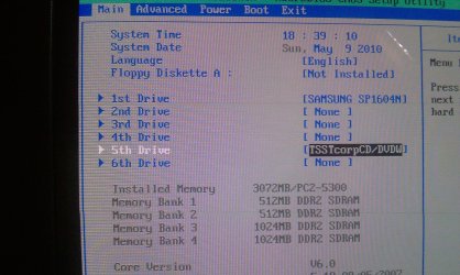

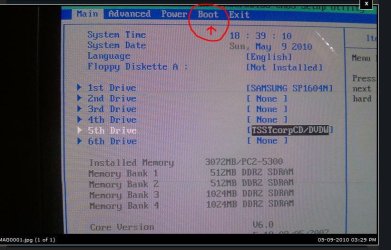

I went to a friends house and used his external USB DVD drive, Got windows on the HDD... my problem now is getting the DVD drive to work on the computer. It's a SATA DVD drive and i feel that the settings in the BIOS is what the problem is. Again, My harddrive on the computer is IDE and that is set as master.

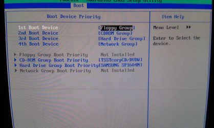

Have you tried the DVD SATA data cable in the other sata MB connections starting with the yellow/orange one ? What is the BOOT order setting under the BOOT tab in the bios settings ?

I have tried the other slots...

Since there is no floppy installed, try moving CD/DVd to 1st position & HD to 2nd position
