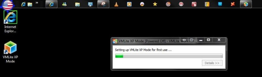

From VMLite Wizard, choose option 2 to import from the VHD file. This way, you will use your original VPC vhd file, all of your apps inside will be preserved.
windows 7
windows 7
Good point! In fact the VMLite Work Station for the XP Mode will automatically look for the vhd in the original location under the user account and configure things for you.

Thank you Kari and Huisinro. Your advice worked. Everything works perfectly in VirtualBox.
