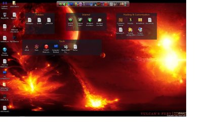

Shawn, here's the screen shot of the problem. The image part of the desktop shortcut icons are blank.
It's happened on three clean reinstalls of the RC. build 7100. Starts ok, but after a few reboots the image has gone again.
Thanks,
David.

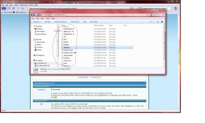

I turned on my puter today and low and behold no Icon graphics just the
lil white red and blue boxes where icons usually are any suggestions on repairing this little issue.. thanx
john:sarc:
that being said I have no Icon Cache db either and all my system icons within the system folders are also the same style as the icons on the desktop
this is annoying

Did you set the hidden system files to be displayed in step 1 first to see that file? ;)
i seriously would not be that stupid to post in a forum!! if I had not checked that firt ...please give me some credit I am a noob yes stupid no!!
