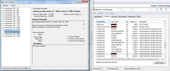

I am running 32-bit Windows 7 Professional on my laptop [Core2Duo P9300; 2GB RAM] and everything was going smoothly up until yesterday when suddenly, the fan started to ramp up and continue blowing at startup (usually, when I press the power button, the fan will start, but then it'll die down by the time the OS boots up).
That's when I opened up Task Manager and noticed svchost.exe was using ~50 in the CPU column. I tried checking what services were running under it, but when I clicked "go to Services," no services were highlighted! What's even stranger is, under the "User Name" heading, instead of System, Local Service, or Network Service [like the other instances of svchost running], it just says my computer's name [for the purpose of privacy, we'll say my computer's name is goluxor].

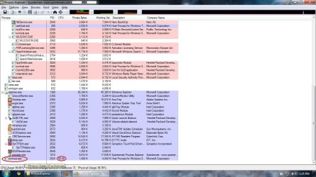

I then used Process Explorer to double check things [screenshot attached], and it also showed nothing was running under it.
svchost Viewer also yielded nothing. In fact, this is what it said verbatim:
No Service(s) Where [sic] found for "svchost" with PID :2824
This is not normal, it is strongly recommended you check
if this is a program you want to have running.
Command line used to start the process:
C:\Windows\system32\svchost.exe -k netsvcs
Path to the executable file:
Description:
svchost.exe
On a lark, I decided to "end process" the errant svchost.exe, and that seems to have freed up my CPU and stopped my fan. However, upon restart, the same problems comes back. I've ran anti-viruses (Avast and Malwarebytes Anti-Malware), but they haven't picked anything up. My Windows Automatic Updater is also disabled. Now, I'm all out of ideas on what to do, and I hope y'all can help. Thanks.

How about a system restore to before yesterday. This is an interesting problem. I have never seen a svchost.exe without an associated .dll.
Success! I tried my antivirus programs again after updating the definitions lists from yesterday and I seem to have caught a "Trojan.Dropper" named wwwbyh32.exe. Seems to be very new or very rare b/c Goggle turned up barely anything on it, but it seems to have fixed my problem as there is no longer a rogue svchost.exe and my CPU is now back to its old idling levels of single-digits.

I just wanted to add and ask, when running Process Explorer, did you run it as an administrator?
Right click Procexp and choose run as admin, ...then click "yes" for the uac pop-up. It does make a difference in the amount of info shown.

Thanks for the tip. I remember I did run Process Explorer as "run as admin" at least once (I think on accident), but I don't actually remember noticing anything different unfortunately.

Just wanted to show the difference in running it in limited vs. admin. Its making my images a lier out of me now, as I just opened it up again with limited user permissions and some apps were described. I'd imagine it would make a difference when working with the processes. There are tools within Procexe that allow you to kill processes and if in a limited user setting, it might not let you do certain things. I'm for sure they're others that could tell you more about procexp than I, so I'll leave it at that. lol
