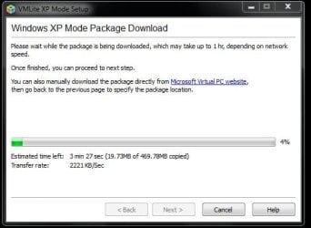

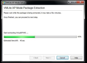

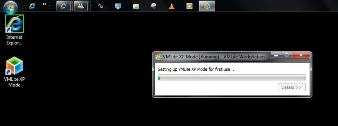

I'm presently giving both a run on an old Socket A single core XP build with only 1gb of memory installed where I have been running some compatibily tests for the temp 32bit 7 install. Have to see how this one goes. :D
Well there you have it! The VM Lite Workstation has successfully downloaded, initialized, mounted, and is running the XP Mode on the following hardwares.

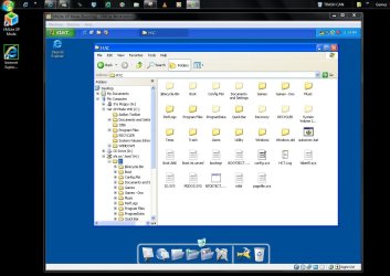

The last screen shows the advantage of the XP Mode's one item integrated components having direct access to the host's main drive.

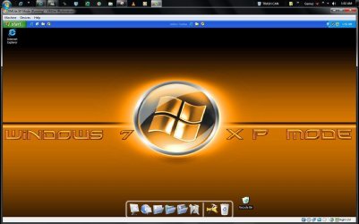

I was impressed just having downloaded the latest now seen on this old build for a look to see if the XP Mode would even run along with the Lite Workstation. The screens there do show that this will help a large number of people out there lacking hardware support for the virtualization requirement seen for the VPC but still need the XP Mode by itself.
For the most part not too many will be running a 6-7yr. old custom case however but would typically see 2gb even DDR400 up until the 939 boards for the AMD side of things. This of course also helps those out who have certain Intel model cpus that also lack the support there too.
Hope to see the next version tried out on this oldie as well as the new build there since the integrated components works as well as on the VM ware unlike simply custom installing the previous version on VBox or a virtual disk while it only sees access to one optical drive or a floppy.
When going on this old case it automatically configured the amount of memory and set that to 256mb as well as the other settings you would go through before the first start.
The only problem was seen in the Help where no content was seen under each topic besides an opening paragraph when looking through for the manual configuration prior to seeing the VBox version of VBox screen come up. This may have been an installation glitch as far as the docs but everything is quite responsive considering the hardwares.
