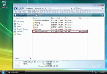

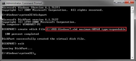

Type of the VHD-File: Fixed vs. Expandable
It is an excellent documentation offered here in that forum, and I successful installed Windows 7 x86 RC on my Thinkpad z61p using a USB-Stick as a installation media and a VHD as installation target.
But on question / problem came up, the size of that VHD-File for a full Windows 7-installation and Office etc.
Diskpart offeres two types of VHD-Files, FIXED (Default) and EXPANDABLE.
DISKPART
CREATE VDISK FILE=C:\VHD\<filename>.vhd MAXIMUM=25000 TYPE=EXPANDABLE
In FIXED mode (as I understand) the max value will be allocation right now, the size will be 25Gig. In EXPANDABLE mode the size will be that amount of data, which is used by the installation, not more and the size at all can grow up to 25 GB (same behaviour as with Virtual PC or VMWare Workstation).
So I selected a MAXIUM of 100 GB thinking the effective size will be just around 15-20 Gig. But as I looked into the explorer, the file is 100 GB in size and the underlying Vista installation has a lack of free disk space now.
I cannot see any difference in the allocated size of my VHD, but I have created it with the TYPE=EXPANDABLE option and diskpart reports the Type as expandable - But the size is fixed to the maximum.
Does anyone here has similar experiences?
Is there a method to shrink the VHD?
What about a comparison in using a VHD vs. shrinking Vista and using a own partition for Windows 7?
What about Hypernation in a VHD?
Lots of questions
Greetings from Switzerland and Thanks in Advance
Oblomow

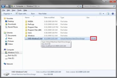

31 May 2009   #29
Brink
64-bit Windows 7 Ultimate SP1 & Windows 8 Enterprise
Texas
Hello Oblomow,
Sorry for the late reply, but it took a bit to play with this to see what options may be available for you.
I have added a option to create either a fixed or expandable VHD file option to help give more options.
When using the type=expandable command, the VHD file will be exandable, but it will require installing Windows Virtual PC to actually see the VHD file as the smaller expandable size instead of the full fixed size. It seems that without that program installed to have associated with VHD files types, Windows 7 will still only show the maximum size instead whether it is fixed or expandable.
I find that it's usually best to backup anything on the VHD that you did not want to lose, then delete it and create a new VHD file the size that you wanted instead of trying to shrink an existing one.
Hope this helps,
Shawn
