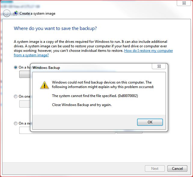

It appears this is a USB issue rather than Win Backup/Restore issue..or maybe combined ?
Repeatedly...if I connect the usb cable to the external drive...I get the error attached.
If I eject the USB drive...then I get all my HDD drives listed as backup devices (except of course the 4 USB partitions)
More confusing...once or twice all my drives showed up in Windows Backup/Restore .."Create a System Image" option...but I can not repeat this very often...
Mostly if the drive is attached...nothing shows up...if I eject the USB drive...all my HDD's appeqr...if I reconnect the USB drive and refresh and/or restart Backup/Restore...then no drives show up as in the jpg attached ?
If I backup to any of my USB drives...I'll have to bu first to the HDD...and then move to the USB
Weird thing is this just started to be an issue a week ago...previousuy all my drives showed up under "create a system image" ???
Thanks...Tim

OK...was going to uninstall Acronis True Image Home 2011 anyway to see if that was indeed the issue..
But...after uninstall of Acronis...Windows Backup and Restore does not start....either thru control panel or any of the help file links....?
When clicking on Backup and Restore links...nothing happens...??
Is there an exe file somewhere I can try to click on directly...and if nothing works...how can I re-enable Windows 7 Backup and Restore functionality ??
Thanks

Vista x64 / 7 X64
Here is the fix WinSysImgRestore.zip
I just tried it - to find TrustedInstaller is the owner of that key. (At least it should be )
You will need to search for {B98A2BEA-7D42-4558-8BD1-832F41BAC6FD} in regedit.
Rt click the key>properties>security>advanced > make your username Owner, then give your username Full Control.
Merge the above .reg file.
Then go back to that key, untick your Full Control, go Advanced and make Trusted Installer owner again.
NB - when you go back to make trusted installer owner - it isn't listed.
Under Owner Tab, you have to click "Other Users or Groups", type in NT Service\TrustedInstaller then click Check Name, click OK and he will be listed so you can make him owner again.
Bit of a faff I'm afraid.
