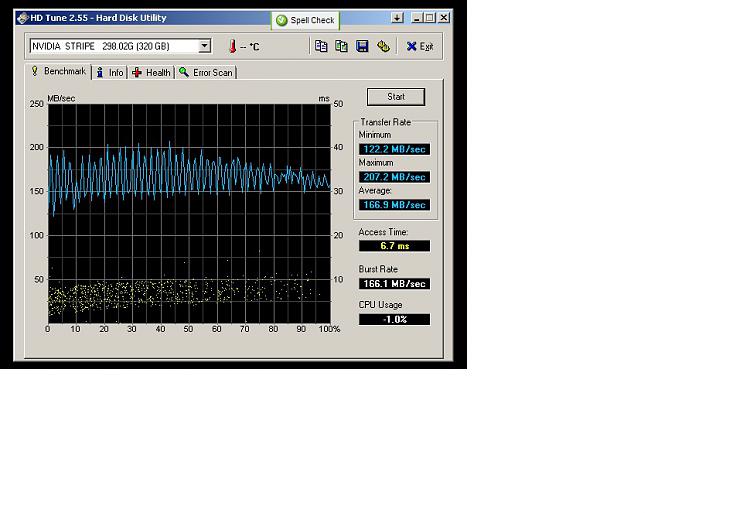

Thanks for that additional link, whs. BTW: I've attached the spec's for the Velociraptors in RAID 0 Upgrading to SSDs in RAID 0-raptors.jpg

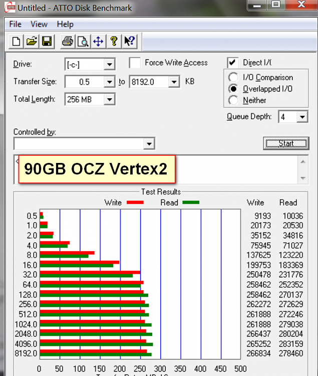

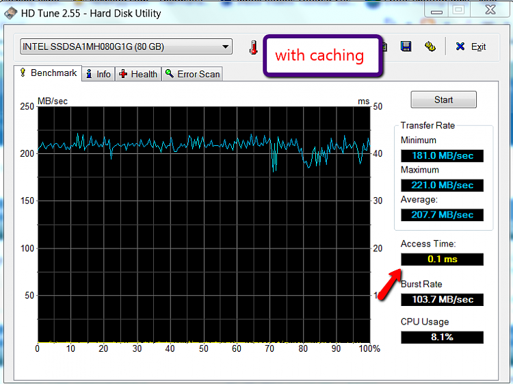

The access time is a bit faster than I thought. But it is still 67 times slower than an SSD. Here are a couple of my SSDs as an example:
Upgrading to SSDs in RAID 0-2011-01-21_1119.png   Upgrading to SSDs in RAID 0-vertex2.png
