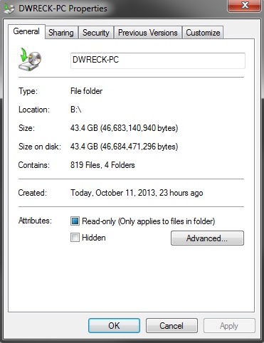

    I excluded "System Reserved" by using the option in Backup and Restore to not back it up. I took a screenshot of the setting and attached it, its the little text in the bottom left. To make sure it wasn't taking info from other HDD's I removed all but the HDD I'm backing up and the HDD I use as the backup. The HDD I use for backups though is just a partitioned part of my storage HDD so there is really another HDD connected still.
    Update: I attached the VHD and explored it. I found that it is the same size as my HDD, only off by 1GB because of things that simply can't be backed up, and that everything is there and not duplicated. I did see why it's bigger. In the other Image I attached you'll see that this file is an extra 40GB. I can't really find out what that file does exactly, when I mounted my backup it wasn't from this file and the VHD looked fine so I can't see what it does. Any ideas on that?

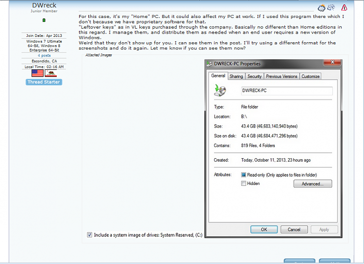

    For this case, it's my "Home" PC. But it could also affect my PC at work. If I used this program there which I don't because we have proprietary software for that.
    "Leftover keys" as in VL keys purchased through the company. Basically no different than Home editions in this regard. I manage them, and distribute them as needed when an end user requires a new version of Windows.
    Weird that they don't show up for you. I can see them in the post. I'll try using a different format for the screenshots and do it again. Let me know if you can see them now?

    The text on the left is the first image. When you asked how I excluded System Reserved I unchecked that box to do so. The B drive is the backup partition of my storage drive. C for (C)omputer On SSD, E for (E)xtension On Storage HDD Partition 1, and B for (B)ackup On Storage HDD Partition 2. This new screenshot I added to this reply is a view of what my backup partition looks like, all the files included in the backup. The first one "DWRECK-PC" is the 40GB file I spoke of. I can't figure out what it does, because when I mounted the VHD I used the "WindowsImageBackup" folder to access the backup, not the "DWRECK-PC" file.
