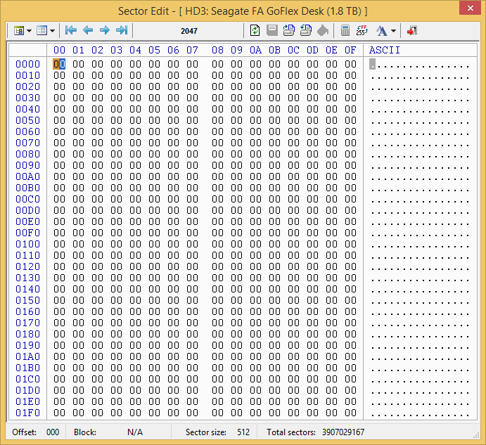

    I checked sector 2047 and 2048 and the former is 0'd but data starts at 2048. I am posting the screens below.
  5. Posts : 10,796
       #85
    Read #7 . It looks like partition start sector was 63 by default(?) Now sectors 0-2047 are zeroed. Sector 63-2047 did belong to partition 1. Sector didn't start on sector 2028 for sure! It has no "readable strings" whatsoever. PW and testdisk couldn't recover the partition as well.
