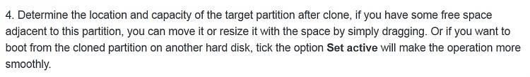

    I'm using EaseUS to clone my current C: drive onto an mSATA (currently A: ) which is already fitted and recognised in the BIOS.
    During the cloning setup there is a box above the target mSATA "Set active" - I would think that this is so that the system can boot from it, which is what I want.
    However, EaseUS's Help has confused me, it gives me the impression that I only tick "Set active" if I want the laptop to boot from "the cloned partition on another hard disk"
    What exactly confuses you about "the cloned partition on another hard disk"? Can you clarify that?
    I agree that the EaseUS instructions aren't well written and the intent is not crystal clear.
    The active partition typically contains the loader for an operating system, but I often see situations where partitions are marked "active" unnecessarily.
    I take it to mean that I do NOT tick the "Set active" box because I want to boot from the A: drive I'm cloning to, not from "the cloned partition on another hard disk".

    My guess is that the instructions are rather generic and intended to fit all cases.
    Therefore my take would be that you should tick it to set active.
    I'd think you could later correct it if wrong---or even re-clone if necessary and make the other choice.

    The "cloned partition on another disk" will be the mSATA you cloned too, so yes it does need to be active. This shouldn't affect the original drive.
    Be sure the system is capable of booting from the mSATA slot, not all can and are used for drive caching only.
