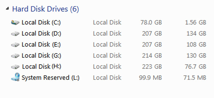

    Hello,
    I'm a little confused and could use a recommendation.
    I just got my machine running after a crash and I didnt have an image backup so I was dreading a reinstall because I would lose all my other programs ...
    I'm running Win7 Ultimate X64 and I have a 1T Western Digital drive with 6 partitions. Its 2 yrs old.
    I don't want to image the entire 1T drive - I have backups of the files. I just want to image windows, the programs and whatever else is needed. So, its probably just the C:/ drive partition and ??? maybe the L:/. I don't know. I have several spare 160 and 320G hard drives to use.
    You can see I have a bad situation because I have very nearly maxed out the C: drive. I would like to re-partition and get more space for C: but I dont want to cause a crash or lose personal files.
    Thanks very much.
    Attached Thumbnails Attached Thumbnails Win7 ult x64 image backup of c:/-hard-drive.jpg
  2. Posts : 6,330
       #2
    Post a maximized screen print of Disk Management:
    Disk Management - Post a Screen Capture Image
    To get some immediate free space on [C] disable hibernate if you have it enabled, at least temporarily.
    Hibernate - Enable or Disable
    Use WizTree to see if you can find where space is being used by files you don't need on [C].
    They have a portable version - no installation required.
    Antibody Software - WizTree finds the files and folders using the most disk space on your hard drive

  4. Posts : 6,330
       #4
    You have dynamic partitions and I'm not sure what can be done with that.
    It can cause problems and the PC may not boot up.
    You would have to shrink the [D] partition creating free space to the left of the [D] partition.
    Then resize [C] to include the free space.
    But I don't know what will happen if you attempt this with Dynamic partitions.
    I'll ask for more help to see if someone knows you're best approach.
    Do you have an external drive you can create backups on ?
