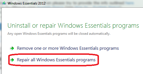

    WLM 2012 Contact Categories Won't Populate Email Address Fields-wemail-cats.pngWLM 2012 Contact Categories Won't Populate Email Address Fields-wlmcat.png
    If that's correct, it appears to be an issue related to upgrading as opposed to a new install. I've been running WLM 2012 since it was released without issue, but I'm a bit of a clean system freak. As soon as one issue crops up I do a fresh base install of the troubling application.
    Ty a repair of WLM.
    WinKey + R brings up the run dialog; type the following in the box to bring up the 'install' dialog
    wlarp.exe
    select repair
    This was not effective in testing done earlier this year but things change.
    I never did write the instructions, so I'll have to work through them again if you can't life without this feature.
