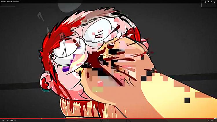

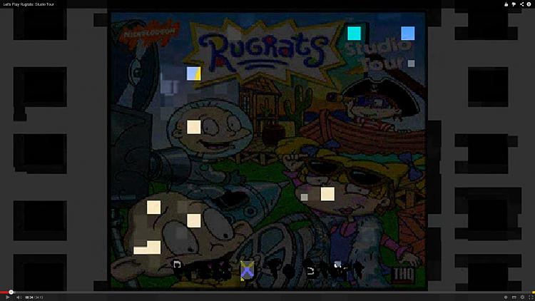

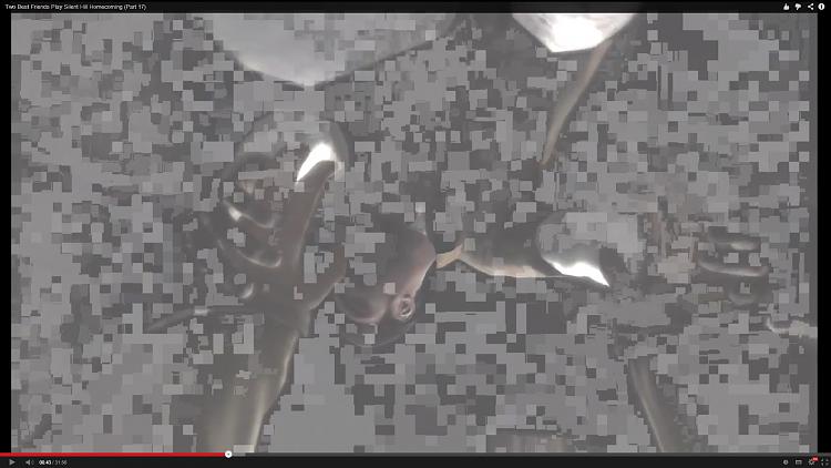

I'm not sure what the proper term is for this problem, but I've recently noticed that the picture on certain YouTube videos gets very glitchy. The second example doesn't appear broken when viewed in HD, but the first (which has no HD options) and third appear no matter what quality the video is set to. This is the case on both my PC and my laptop and doesn't occur when watching the videos on my iPhone. Any advice?

Sorry for being slow again. I tried running Windows 7 in safe mode to see if that solved the problem, and testing it was harder than I expected it to be. Maybe it's because I was using Firefox, but while in safe mode, the two videos I tested (the second and third ones screencapped in my first post) kept jumping back after playing for a couple of seconds, automatically using the highest quality, then throwing up an error message and forcing me to reset. I managed to get a quick glimpse at the third video around at one of the points where the problem occurs, and the picture was still screwy.
