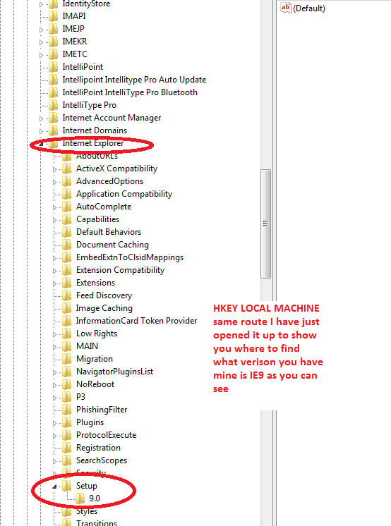

Now my two cents worth as well as what the others have said and this option is entirely up to you.
You could do a system restore I suppose back to before the update for 10 was done and see what it has then go to updates scroll down and "hide" the 10 update.
To do that right click it in available updates and hide.
Now the other option is in the registry. What I have done in the past is to go into regedit and use to change stuff admin hit the HKEY for the USER and LOCAL MACHINE listings open up Software > Microsoft > internet explorer > right click the whole entry > delete.
Now before you go to that extreme you need to back up the whole registry > File > export > find a spot to put it (I use either documents s or the desktop > let it run takes less than a minute > then go back and do the above.
Now this will delete the entire internet explorer from the machine's registry and you must make sure you have the IE9 downloaded into Downloads before you even think about this option and I also for insurance save that download to a stick.
Then just reinstall the IE9.
Now you do this at your own risk but as I said I have done this on a few occasions for IE10 and other stuff that even Revo will not cope with like some of those irritating add on bars you accidentally download and cannot get rid of.
