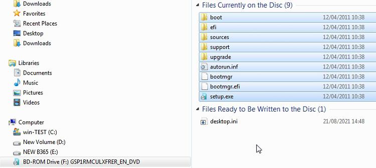

    copy the contents, the files and folders highlighted in blue

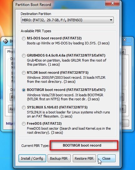

    might be worth checking the usb stick with bootice
    BOOTICE-1.3.4x86.zip
    select usb stick in the dropdown
    clcik process mbr
    it should say NT6
    click process pbr
    it should say bootmgr boot record
