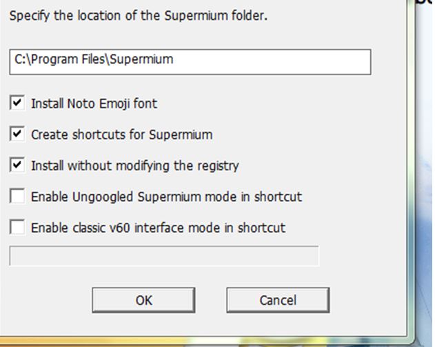

    I’m going to reinstall Supermium, however, does anyone know what this means when downloading “ Enable Ungoogled Supermium mode in shortcut.” Would this give me an ungoogled version which looks and acts the same as the normal version?

    Don't hold me to this but I think that the biggest difference with ungoogled chromium is no google extensions. Read this: Ungoogled Chromium If you want a Firefox based up to date browser go with r3dfox r3dfox, modern Firefox for Windows 7! You still won't be able to download from Youtube directly but there are extensions. Keep in mind Google completely blocked that years ago. As you stated you previously had an extension. Technically I don't think that we can help with that due to the rules.

    Thank you. "The biggest difference with ungoogled chromium is no google extensions." That is just what I'm after although Firefox doesn't agree with my computer. I've created a restore point, made a system image and when I get an opportunity, I'll download Supermium with that 'ungoogled' part ticked and see what happens. I'll update the thread with the results.

    I've installed Supermium, ticking that essential box and I believe I have ungoogled version. I'm not sure how you actively test it but on Chrome on the top right hand side you have 'gmail, images and an icon with all the google apps' - that part is missing on Supermium. Also Google is missing from the search engine options. Just need to run it for a few days to ensure everything works ok.
