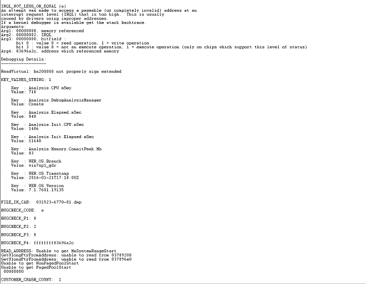

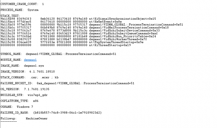

    The company I work for has a press brake with a computer running Windows 7. The computer is NOT connected to the network/internet.
    A technician for the press brake manufacturer was recently on-site and updated the machine. Frankly, I don't know exactly what the updating entailed. Pursuant to this, the computer has intermittently "blue-screened" while in use. I've done the following:
    1) Ran sfc /scannow. Corrupt files were found and repaired.
    2) Ran chkdsk at restart.
    3) Ran Memtest (passed).
    I found the following when looking at one of the .dmp files through Windbg:
    NOTE: I decided to add pictures since the copy/paste in this post crammed everything together.
    I'd appreciate any help/suggestions regarding this matter. Thank you.
    Attached Thumbnails Attached Thumbnails Seeking help regarding intermittent BSOD-bsod-ss1.png   Seeking help regarding intermittent BSOD-bsod-ss2.png

    Not a BSOD expert but judging by this post,
    Constant BSOD on older comp (GPU side grade) - Windows 10 Forums
    looks like your GPU drivers.......
    as its not connected to the net "updating" the driver is not a viable option
    I'd give the tech a quick call, ask him what he did is POSSIBLY reversable
