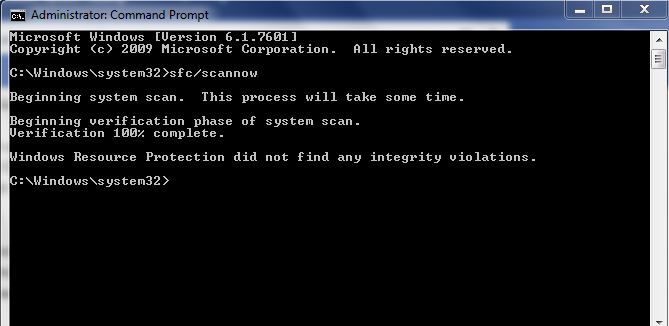

    I ran sfc/scannow which did not show any problems but I thought that when I had ran that previously quite some time ago there was a full onscreen box of text after the scan - I am wondering if it worked correctly - I am attaching a screenshot of the result.
    To run sfc/scannow I opened Command prompt / run as Administrator - typed in sfc/scannow and hit the Enter key to start the scan.

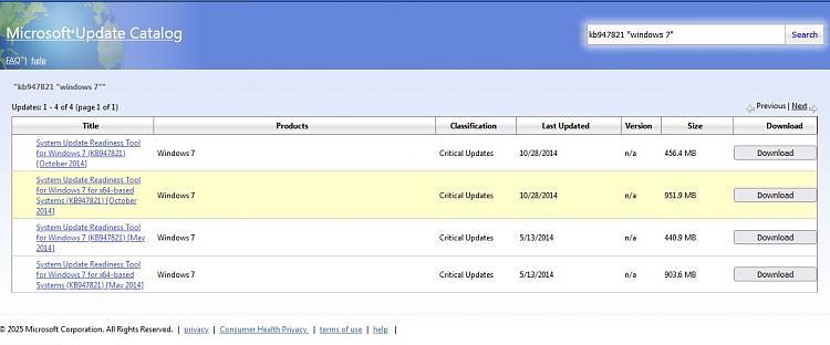

    Regarding the Microsoft update from the Microsoft update catelogue that you gave me a link to - when I clicked onto the link and went to the Catelogue webpage there were 4 x updates listed - 2 are showing that they are 64bit versions and although the first / top one is dated October 2014 I wanted to check with you whether this is correct for my Computer`s 32bit version of Windows 7 Home Premium ?
    I have attached a screenshot of the Microsoft Update Catelogue webpage so that you can see what I mean.

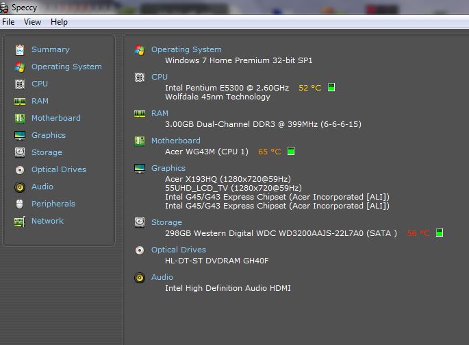

    P.S: Before you replied to me on here and then viewed my Computer`s System Information files I had been wondering if my Computer had been over heating which I thought might have been causing the BSOD events - although it is well ventilated all around the Desktop unit casing I am sure that I have heard the Fan running more frequently and for longer periods and not just on really warm days.
    I have had a program called Speccy on my Computer for years - never been any use to me but I left it on there - when opening it there are temperature measurements showing for the Motherboard etc. - they look quite high Centigrade temperatures to me - mid 50`s - mid 60`s Centigrade ?
    I have attached a screenshot of that Speccy result from earlier today - do you think that the various temperatures showing are normal operating temperatures / O.K. ?
    I am guessing that the small green indicator box adjacent to those temperatures would go to red if there was an overheat temperature ?
    Thanks again, Chris
