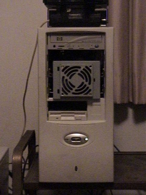

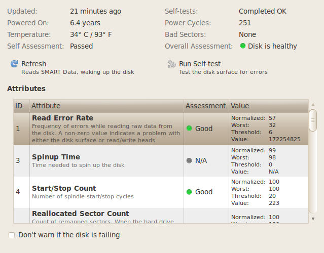

The first picture is a cooling mod for a Seagate 250GB HDD that ran at what I considered to be an elevated temperature (110F, 43C). As you can tell, it's part of a (dead) Compaq power supply. I guess it worked as that drive is still in service (see screenshot).
