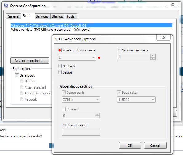

    Airbot said:
    Correct me if I'm wrong but modifying the fallout ini file to a 2 core limit, only lets that game use 2 cores, it won't have any system wide effect, or limit your processor for anything else.
    To be honest, I actually missed that. When I heard (read) about the core fix I imediately thought of this fix ....
    Obviously this isn't the fix you're advocating. Since you're only modifying the "games" inf file it wouldn't have no impact on the rest of the system. I missed that part
    From that standpoint, it makes it an even better suggestion
    Thanks for getting me straight
  4. Posts : 18,404
       #434
    No problem. Yeah, it isn't that change from the boot tab, just isolated to the fallout game itself. Which makes it a good suggestion as you say.
