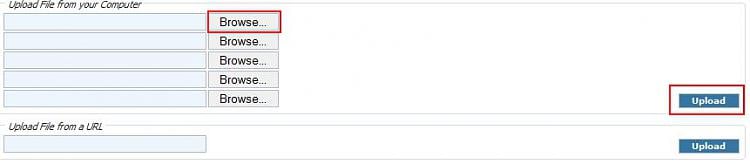

    And yes, you can add screenshots to your posts if you want to:
    Press the little paperclip above the Window when making a post..
    In the next Window, just hit browse to pick the pictures you want, and then click the upload button on the right.
    When it finishes uploading them, just hit the close button at the bottom of that page, and resume editing your post.
    Your screenshots will be added to your post when you submit it.
