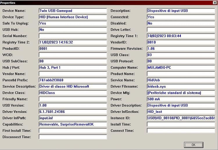

    Thanks, I didn't know about that program, unfortunely on Windows it is shown as two joypads, but on usbdeview it is show as one device
    I also noticed RE5 recognizes keyboard or the first joypad as main "profile":
    - if I go through "Start Game" by using keyboard then use the second joypad, it loads the savegame correctly
    - if I do that by using the second joypad, it doesn't load the savegame (bogus gamer profile prompt forcing to proceed without saving)
    - if I do that by using the first joypad, it says "Control mode switched to joypad" then it loads the savegame correctly
    I'm clueless, I guess the only way out of this is somebody who can release a patch or something like that, for non-steam versions (like Gold or something... I heard about "QOL" patch but it really wasn't my case as it didn't work).
