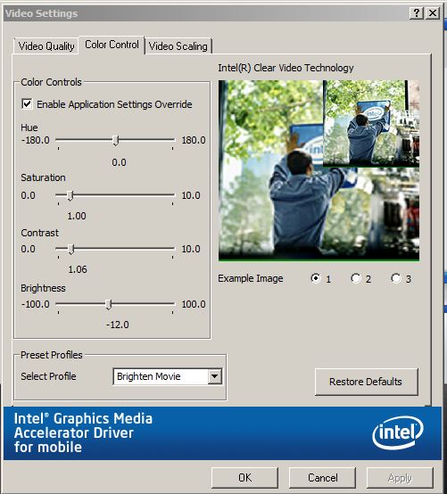

    I suspect this is the problem: Whenever I un-check "Enable Application settings Overide" it re-check itself after a re-boot or log-off???
    Attached Thumbnails Attached Thumbnails Color profiles calibration?-capture.jpg
