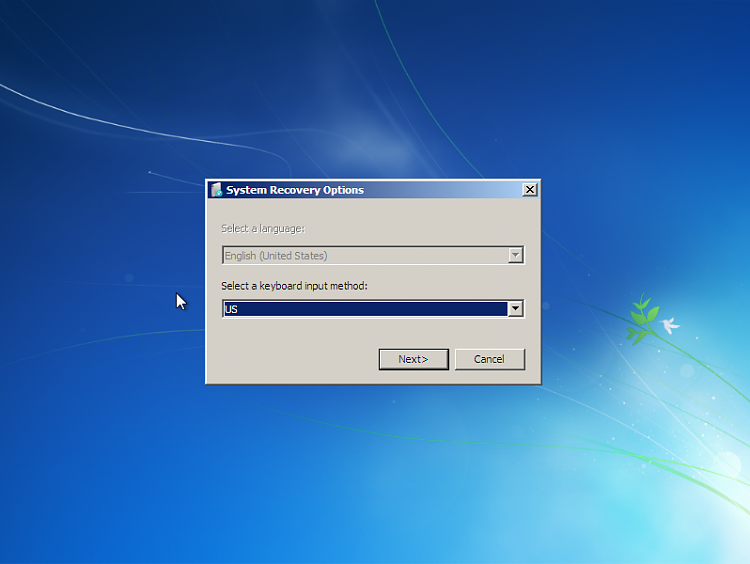

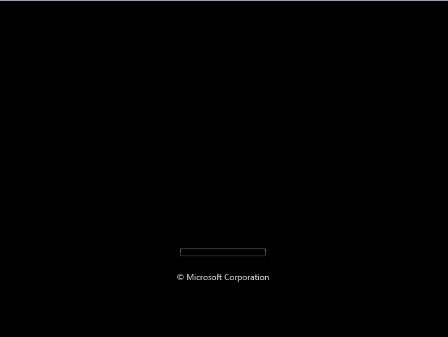

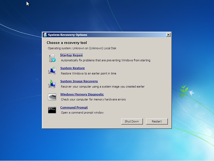

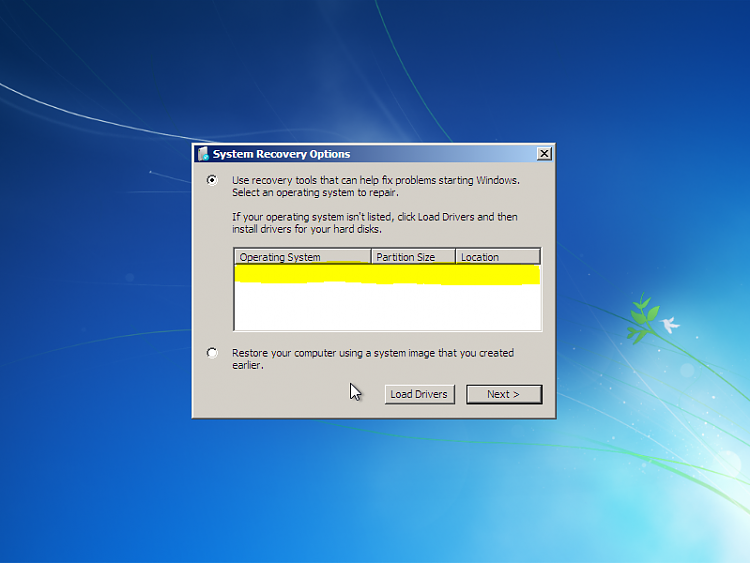

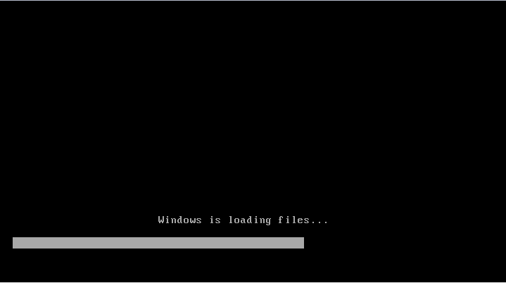

It all sounds promising, but I'm unable to figure out where exactly to initiate this Shift+F10 key combination. I've been hitting this key combination from the moment it started loading until the GUI pops up, but nothing seems to change.
The only thing that seems to respond to interrupt the loading process at some stage is F8,
Took the snapshots with the use of a virtual machine, for picture are better than words. Image/Attachment number three & four, after I pick the language settings a loading/analyzing process starts, that takes ages on a disk that is damaged.
Because I took the snapshots on a blank virtual machine it didn't found anything, but the in yellow highlighted area normally reads a line indicating the system in found.
Clicking the next button will initiate another long lasting process that ones completed allows me to reboot and doesn't present met the fifth image/attachment. Only after repeating everything for a second time I end up where I need to be, an option to go to command prompt.
I've got the HDD Diagnostic's covered, I got my own set of tools for that, but it never hurts expanding my collection of tools. Currently exploring what this "Paragon Rescue CD" is able to do.
My main focus now is attempting to be able to repair and recover the data and file system with check disk (chkdsk) or something equal and does the exact same thing without the long wait to get to the command prompt console.

Use the Command Prompt here:
Follow the steps given in the Disk Check tutorial. Then download, burn to CD and run the maker's HD Diagnostic extended CD scan.
If these check out, go back the to the Repair CD/DVD Command Line to run the commands bootrec /fixboot and bootrec /fixmbr to see if it then finds an installation to repair. If not run Startup Repair a few times anyway.
If these all fail one last resort before copying out your files using DVD/CD or Paragon Rescue CD then reinstalling or running Factory Recovery: Boot free Partition Wizard bootable CD to make sure the Win7 partition or its 100mb System Reserved partition (preferred) are marked Active, then click on HD to highlight it, from Disk tab select Rebuild MBR, reboot. If Win7 fails to start but needed marking Active, try again running Startup Repair up to 3 separate times with reboots.
