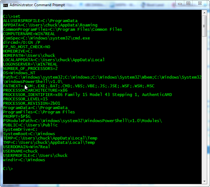

    At C:> type SET
    and post that. May be a hint in there.
    Should look something like this:

    This would leave you with still only 1 partition, but with 2 installations: the bad one in C:\Windows and another in a .vhd file.
    Theoretically, the .vhd would be bootable as the first entry in Bootmgr with the bad install as the second entry.
    OTOH, it might not work...
    The only thing you could gain from this is to have a "real" functional bootable Win7 (vice .wim image file), I think, which might allow you to do troubleshooting on the misfit C:\Windows.
    Sort of a "BartPE" on the same HDD, contained as a single .vhd file...
    Kind of gutsy, and, wandering into the unknown... Also, there are some limitations on vhd installations.
    There's still the option to 'squeeze' the one partition down, creating new space for a 2nd partition, and a 2nd installation put there, as you were pondering before.
    Sorry Mike.
