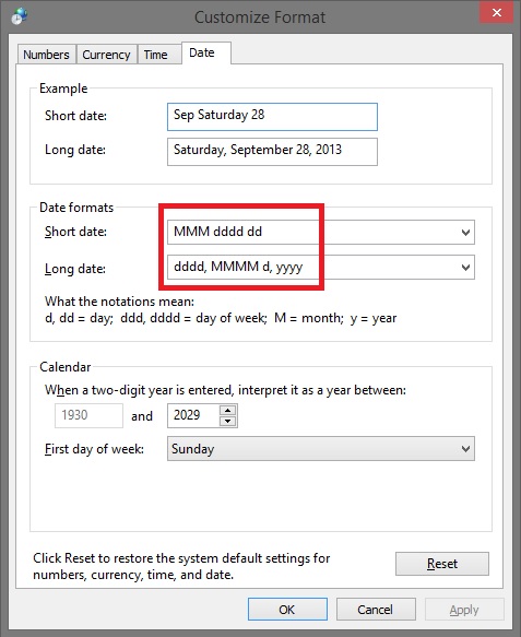

Normally file properties use the "Long date" format, and the taskbar uses the "Short date" format.
Here's what I have mine set as for something like you may want.
How to change the taskbar clock without affecting the file properties-date_format.jpg
If you are seeing something different in file properties, then please post a screenshot to see what the issue may be.

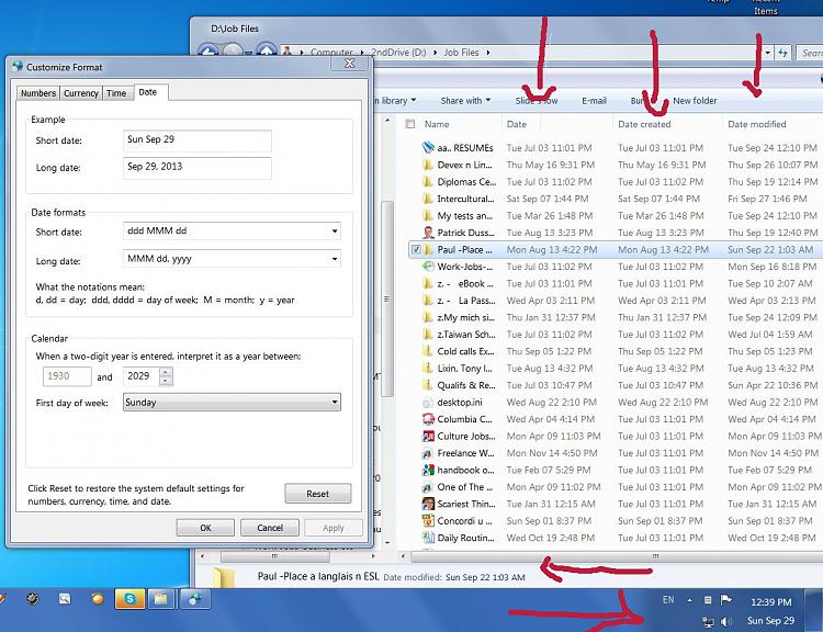

sorry 4got to do so last time (idiot me).
You'll note how 'Long Date" does have the year but shows it nowhere, as indicated by all 5 red arrows.
it also shows you how in short date there is 'ddd' for day of the week, and it is in fact this that is showing--hence my having concluded that the opposite is happening--file properties are actually showing the short date and not the long date

Ah, ok. Yeah, that will still use the "Short date" format. I was thinking the "Long date" format used in the properties page of files like below.
How to change the taskbar clock without affecting the file properties-properties.jpg
