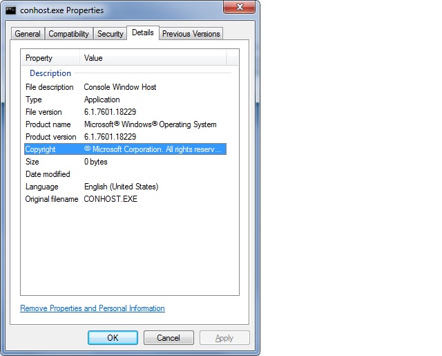

  6. Posts : 2,470
    Windows 7 Home Premium
       #6
    rzn6jw,
    Did you look at the conhost.exe file properties, and see if it is running from the system32 folder?
    Is it a Microsoft file?
    Please post the General and Detail tabs of the file's Properties.

  8. Posts : 114
    Windows 7 Pro 64-bit Service Pack 1
    Thread Starter
       #8
    Yes, it looks like it's coming from the system 32 folder (I'm running 64 bit Win 7 Pro).
    Attached Thumbnails Attached Thumbnails Conhost.exe cannot be terminated from Task Manager at system reboot-conhost.jpg   Conhost.exe cannot be terminated from Task Manager at system reboot-conhost1.jpg
  9. Posts : 2,470
       #9
    Size = 0 Bytes!!! Oh boy!!
