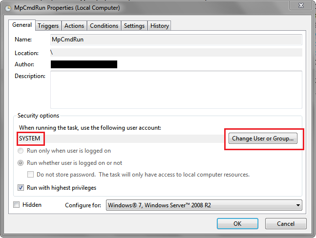

    Try changing the user to SYSTEM and see if the task works the way you want.
