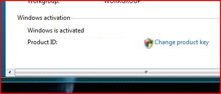

    I removed the beta and Vista still remained deactivated. So I decided to install Vista again on the empty partition (dual boot Vista and Vista) and lo and behold, the original installation re-activated
    I now have my desktop back, Windows Updates are working etc HOWEVER, I still have the "This Copy of Windows is not genuine" notice in the bottom right hand corner.
    To me, this is utterly odd behavior

    The only thing I can think of is that when I installed the beta, it over-rode something in my original installations c:\ drives boot folder.
    I must admit my knowledge of activation procedures / locations is somewhat limited. I'm sure it would be a simple answer for someone in the know
    Not a simple answer for me however :)
