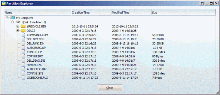

    What is the 306mb FAT partition sitting on the boot sector of Disk1? Was it intended to boot G at some point? It doesn't correspond to any of the partitions on the source drive you cloned/imaged, so why would it be there - except to interfere?
    LOL. It looks like that might have been the boot partition. But, it does correspond to the partitions on the original install that I ghosted over, which is Disk 2 in the screencap above. The 306 MB partition has the same files in it as the first (62.72MB) partition on Disk 2. Here is a screencap of that:
    Working backup Win7 boot drive, need to fix main Win7 boot drive-partitionwizard-smallpartcontents.gif
    To me, those look like boot files. I don't know why the sizes of the partitions are different. Possibly some roundoff difference in how I partitioned the new disk when I ghosted to it. I recall that I wasn't able to make that partition the exact same size for whatever reason.
    Is it possible that I should be trying to fix the boot process on that little partition, instead of on the larger one? Is there a way to go about that? It doesn't have a drive letter in that PW screencap and there was only "C:" shown in the list of Windows installations that comes up in the Startup Repair screen booted from the repair CD (with only that HD connected).

    It's the Dell Diagnostics partition. See if you can boot it now: Run Built-In Diagnostics for Your Dell Computer | Dell US. If not you can delete it. There are no boot files there.
