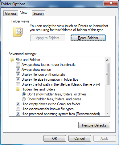

    Please Confirm
    Just want to make sure I understand. I should go to control panel-Appearance and Personalization-folder options; select view tab as attached and click "restore defaults" at lower right. Is this your suggestion?

    No that is something else. You could do reset folders. Restore defaults is for the advanced settings.
    I suggest viewing the tutorial and downloading the bat file to do it. After downloading it, right click and run as administrator. I believe it covers more then what that does there.

    Thanks andrew129260. I didn’t realize your post had a link but I’ve been there now. I haven’t run the batch file since it sounds like it simply automates the process of setting all folder views to their default settings. If I’m wrong about that, please let me know.
    Instead, I went to the folders in question and selected tools-folder options-View and under Folder views, I pressed Reset Folders. As expected, this returned the view settings to the normal expected view. The problem is that it didn’t stay like that! When I booted up the next morning the Network View looked like the 2nd screen shot in my opening post! A mere few hours later it returned itself to normal! It’s as though there is a gremlin in the computer that insists on spontaneously messing with the folder view options. Clearly, I can easily restore defaults, but the issue is getting those default settings to stay put! Again if running the bat file will do more than automate the reset process then let me know and I’ll give it a try. Thanks again and help if you can!
