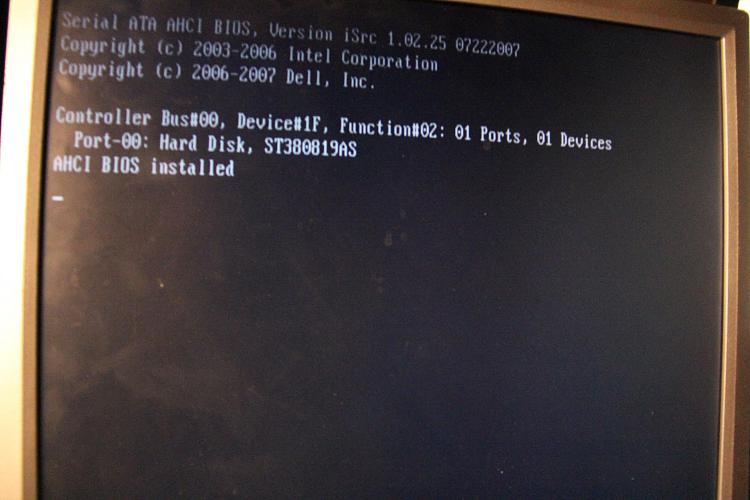

  8. Posts : 30
    Thread Starter
       #28
    Oh Maaaaaan. So this is the thread that never ends. I figured I'd try and match your 'weeks of troubleshooting' : )
    So, all was going well. I specifically would shut down the machine, and restart to see if there were any hiccups. It would restart every time, flawlessly. I did this about 3 or 4 times.
    After that, I did two things.
    1. I plugged in an ethernet cable (to connect to start downloading drivers etc, although I didn't start installing).
    2. I then went into the bios, and made usb later than the sata drive, so that I would not always boot into the windows install any time the usb was left plugged in on a reboot.
    Low and behold, on the next reboot, I am cycling through problems again.
    All I can get is a constant alternation between these two screens (see pictures attached).
    Lol What's so strange to me is things work, then don't work. Work, then don't work.
    I guess I will start trying your ram suggestion next, one at a time.
    Any other thoughts of what might be causing this? There is no beeping now, so maybe that was the bad video card, but what is making it cycle like this is beyond me.
    M14

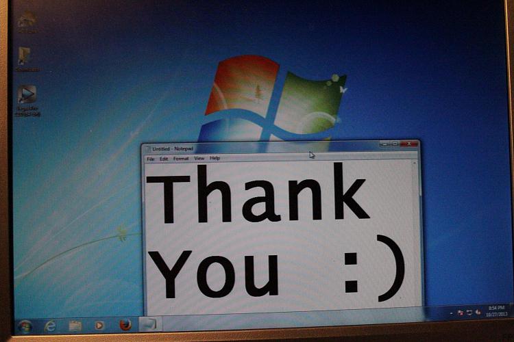

  9. Posts : 30
    Thread Starter
       #29
    Gentlemen,
    eventually got everything running, and it is indeed the video card.
    A happy ending for me, as better the video card then the mother board.
    Thanks again for all help.
    M14
    Attached Thumbnails Attached Thumbnails Takes 2-4 times power on / off before booting (2 beeps) Mystery-img_0934.jpg   Takes 2-4 times power on / off before booting (2 beeps) Mystery-img_0935.jpg
