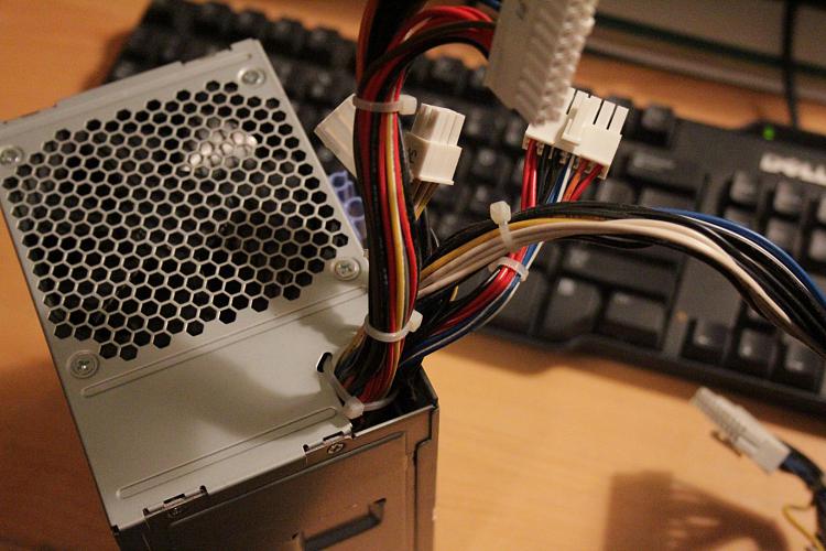

    Hi Guys,
    So, located the new power supply today, installed it annnnnnd, No love
    Well, maybe it was the power supply, that damaged the operating system, and now the operating system is taking me to a black screen? In any case, moving forward. After I power up / down 4 or 5 times, I can get to the system restore option, but it says system restore is offline. Also, when I insert a new W7 disc, it says it's not compatible.
    Does it make sense to: take out system drive, and view it in a dock from another computer to discover exactly which version of W7 it was, then copy that down and try and track down an older disc?
    I have a lot of important data on the disc, so don't want to reformat and loose all info.
    Any suggestions?
    Attached Thumbnails Attached Thumbnails Takes 2-4 times power on / off before booting (2 beeps) Mystery-img_0932.jpg   Takes 2-4 times power on / off before booting (2 beeps) Mystery-img_0930.jpg   Takes 2-4 times power on / off before booting (2 beeps) Mystery-img_0933.jpg
