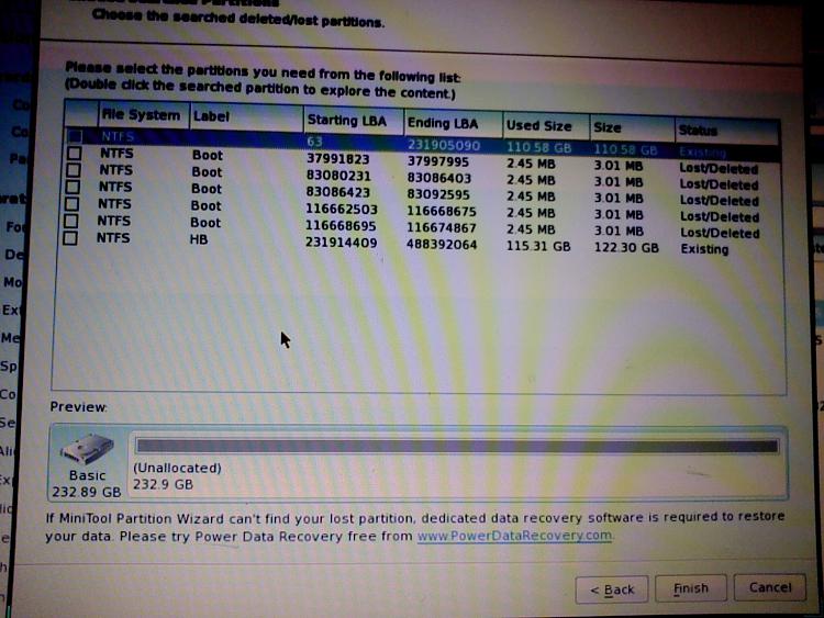

I have done the lost partition recovery and I got what the image attached shows.
The first partition was my old (and existing) local disk c:, however the name and label was removed, and the last one is my local drive d:, named HB.
I'm able to search the content inside HB but I can't do it for the first partition which was the local disk c: where I had Windows 7 installed.
Now what can I do? Is there any way to fix the first partition? Why can't I access it?
Thank you very much.

It would appear the first 5 identical partitions are gone. Wait for Greg to have a look, he's better at recoveries than I am.

When you booted into Partition Wizard were your partitions displayed intact before running Recovery Wizard?
Please post a screenshot of the Partition Wizard drive map and listings showing all columns and drives

Yes they were, I could saw my two partition. The one that I can't acess (and that is on the top of the list of my previously screenshot) and the partition named HB, that I can search the content.
Right now I'm not able to make a screenshot, hope it helps anyway.

Can you right click the C partition in PW to Explore files?
When we see the screenshot we can help more.
